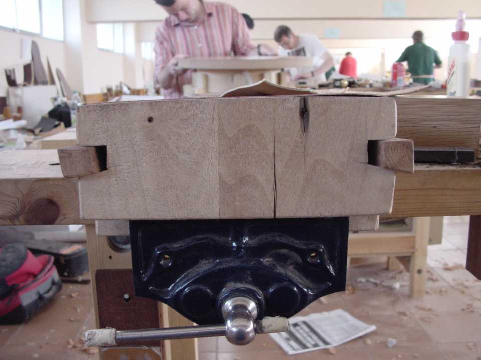

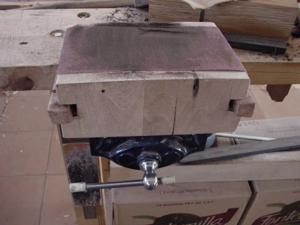

This is the first time I am putting up photos in this website and I hope they show up fine. These photos were taken at Romanillo's guitar making course in Siguenza, Spain. I asked a forum member and a great friend, John Hall (Blues Creek Guitars) to make me an exact duplicate of this jig. The contour of the jig matches that of the dome/doming built into the soundboard. John has made a number of jigs/patterns, etc. for me over the years.

Yep! I made mine with a 12" X 4" piece of MDF on my radius dish, took 10 minutes...and topped with 80g to start, 120 to finish...then a quick scrape right before gluing...works great, although the comment here about the top maybe not ending up exactly the same as the radius dish is a good one...I just haven't made up my mind about sticking sandpaper to a newly finished top!
PostPosted: Wed May 31, 2006 9:12 am
I use a 2x4 sanded in the 28 foot bowl - that gets it close, then I finish up with a scraper just prior to gluing with titebond. I use a chisel to clean that area under the bridge and fingerboard - scares the hell out of students when they see me do this to a freshly buffed out lac finish (I learned this from watching Serge De Jonge one day I visited) but it gives a clean area - and with the sharp chisel you KNOW when you hit the wood fibres. No failures yet.
